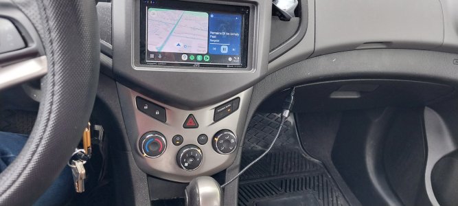

I don't know how much any of this would help, but here is my set-up. The USB is coming through my glove box, I don't know if this ever has anything to do with connectivity. But it was how the Geek Squad installed it.
I see you have an aftermarket head unit, that USB cable u need to follow behind the unit see if it's fully seated as any pulls can pull it out from behind the Head unit
Yeah that was always something I was afraid if as well, though sadly I do not have the expertise enough to go about disassembling things to get back there and see.
Since I'm in the Auto industry when I install a unit for myself or family and they have these loose USB cables I like to make a port like factory so you never see the cable just plug it in that way looks clean and professional
And I make sure the cables, if not hardwired to the HU, are secured in a way that they do not pull out or disassemble from vibration (tight electrical tape wrap, zip ties, etc)
