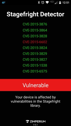

This whole 'Stagefright' business sure reminds me the whole Y2K-made-up-fiasco....
