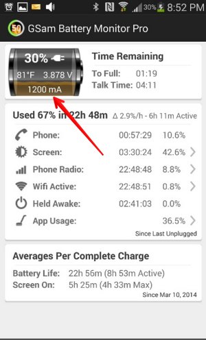

Galaxy S3 USB 2.0 charger & cable delivers 1200 ma to my note 3, which is the same as the stock Note 3 charger & cable!
As reported by Gsam Battery Monitor Pro.
When just running on battery, it reports 450ma

Are you saying that 1200ma from the note3 wall charger via its usb3 is faster than the galaxy s3 charger with its usb 2?

The note 3 power supply should be 2 amp, the "charger" is actually built in, you need to understand that the charging algorithm will change the charging current as the battery charges, battery temp, and percent of charge will affect charging rate, you will probably see Max charge rate between 20% and 80%, depending on temp, I believe it is showing you current charge rate, not maximum. And yes, 3.0 is much faster at data transfer, from a USB 3.0 port, the USB 3.0 cable makes NO difference if using a 2.0 port

@pcguys question really confused me. So it puts out (n3 charger) 2.0 A nominally as stated, but may read 1.2A during the process.

Correct, the device decides how much of that 2 amp to use, it will generally start out high, and come down as charge comes up, it will taper way off after the battery reaches about 95%, battery temperature also has a hugh effect on charge rate. Also, due to resistance, that 2.0 amp power supply will only be able to deliver approximately 1.8 amp to the phone.
