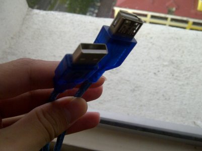

I recently bought a cheap 3 metre USB extender cable off my local store for a few dollars because I was ing about how short the charging cable was. I brought it home and found out that it works. However, it seems to charge really slowly. I just observed just now and found that after 3 hours of charging, it only charges 20pct whereas if I took the cable out and just use stock cable, it charges at 3 pct every 10 minutes. My question is does the cable's length affect the charging current or is it just that my USB cable crappy? How could I solve this cable length issue? Thanks for answering my questions :)

Must be a crappy cable, I bought one which had good reviews on Amazon, 3 metres long and I haven't had any problems, it actually seems better quality than the stock one, and charges just as fast.

OP is using an extension cable, not a replacement.
Short answer is yes - an extension cable (or replacement) can negatively affect charging rates. Any extra resistance anywhere in the charge path will lower the rate.

Yea, you're right, I didn't read the post properly, the simple answer for the OP is to buy a long replacement charger cable rather than use an extension cable.
They probably used a smaller gauge of wire to keep the cost down. As stated too much resistance. You might have to spend a little more. Just wondering if the wire gauge is stated on the package.
To the OP. I've noticed the travel chargers that come with old BlackBerry phones give the fastest charges. If you can find a few of those you'll be set. They tend to come with 5 ft cords as well.

Sorry to dig up this thread but it is true. I bought some nice 10' amazon basics extension cables w/ 3ft usb to micro cables.
I don't get a drain but I have found that I get a much slower charge. So it isn't so much the cable as it is the extention and resistance at that connector.

Jason, something in line that is a great conductor of electricity is what this thread is about. The cables wire gauge in extensions is usually too small to pass the current required. Something to get the current to gain strength is called an amplifier. We just want to charge a tablet. Are you for real?
