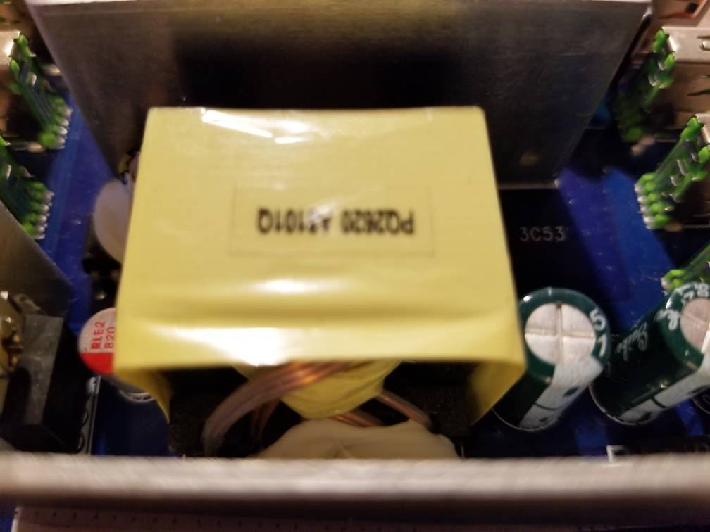

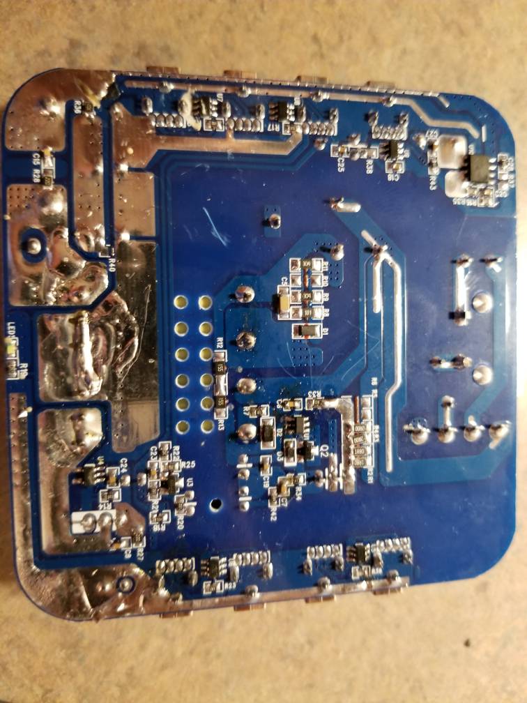

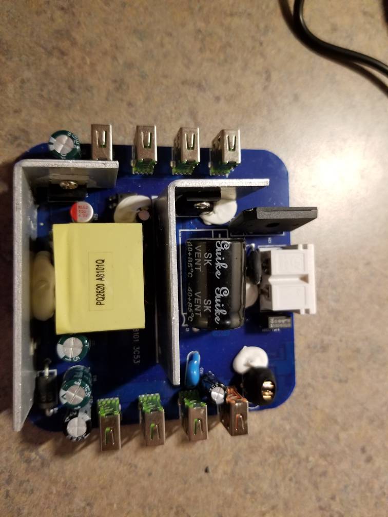

I keep reading stories about small children and even adults dying due to being electrocuted by charging devices and even just by touching a frayed USB cable. They they say how you need to be "careful" when charging. By design you should NOT need to be at all careful with a charger as it should be properly isolated from mains voltage. But those cheap cube chargers from China (and similar junk) frequently have transformers with little to no isolation between the primary and secondary, and the distance between the PCB traces on the primary and secondary side (creepage distance) of the switching power supply is sometimes a millimeter or less (I took one apart last week https://youtu.be/_0i6UESoj2Y). Ideally it should be 4mm and for double isolated chargers 6.4mm. I own the very well built and super safe Ldnio A8101 (I was too cheap to buy Anker or Ravpower, and Aukey chargers like to melt down on a regular basis according to reviews). The A8101 has huge creepage distance and even a secondary trasformer winding WRAPPED IN INSULATION MATERIAL (see provided pictures). The design is top notch, which is to be expected for $20, and is a good example of how a quality high-performance charger is designed. And big-brand-name chargers are only $10 more expensive, so there is no excuse for getting garbage death trap chargers from eBay and back alley phone shops. I seriously do not get why the low quality Chinese junk exists when stuff like the A8101 can be made relatively cheaply and is much much safer. Think twice next time before buying a cheap charger in a gas station or dollar store, as you might be very close to mains voltage and could end up dead like the people in the news.

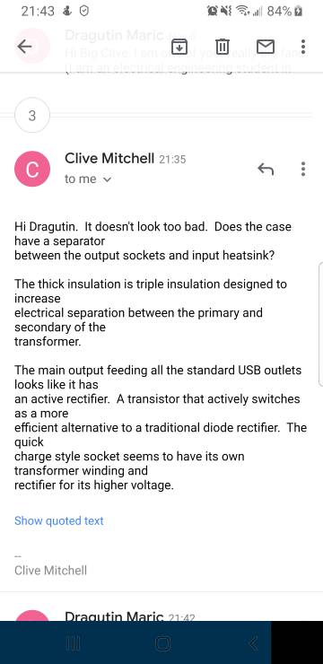

Edit: World-renowned YouTuber BigCliveDotCom has given me some facts about that charger I have that I used as an example of a good one.
