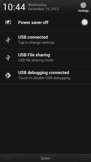

I've been looking around for answers to this, but I haven't found a definitive answer.
There used to be a time that I could plug my EVO to my laptop and it would present me with the option to "Charge Only." Now, all I get is this..
It also brings up HTC Sync on my laptop. When I uncheck "USB Debugging" within "Developers Options," it seems to only be a temporary solution until it forgets and brings it back. Additionally, It doesn't really seem to be doing a very good job of charging.
Does anyone know of a way to bypass all of these unnecessary steps?
Mine used to do this to, but after factory reset I did (for other issues) USB debugging hasn't come back after turning off developer options first time
And when plugging it in, it just charges without doing anything....so it's even easier now because I don't even have to hit "just charge"
Ugh, i'd hate to go through setting everything back up just to fix this little annoyance.

This has already been reported in other threads- both the debugging always showing on, even if turned off, and the no "charge only" option (meaning it WILL immediately connect to the computer, even if you don't want it to).
USB Mass Storage Mode ("Disk Drive") is also completely broken under Linux now (where it used to work fine). Some people reported USB Mass Storage Mode is also broken under other operating systems (I have no direct confirmation of that). MTP Mode ("HTC Sync) is still broken, just like it was before, under Linux.

Just got off the phone with a REAL HTC Tech and have a reasonable answer for this now.
1) The phone WILL turn on USB debugging mode automatically, even if it is turned off, if it senses there is an issue connecting to the computer. Has something to do with helping to initiate driver detection and installation on the computer side.
2) There is no USB Mass Storage mode at all anymore. "Disk Drive" is now MTP.
3) Although I can use MTP mode on other Android devices under Linux, I still can't with the HTC Evo. Not sure why, though.
4) When I attempt to use HTC "Sync" mode, that apparently uses PTP mode, and my systems detect that, but no pictures are present.

Well, it's not a fix. But, i can live with confirmation for now. Thanks, crxssi.
