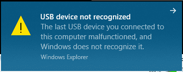

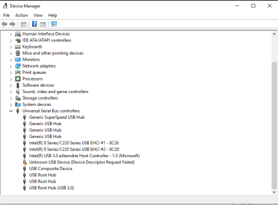

i installed smart switch but usb device not recognized when i hook up the phone galaxy core prime g360h i changed cables and when i try other samsung phone it can connect and COM port is open and detected on odin

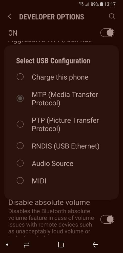

What is the setting you have here in Developer Options?
nope cant go to that screen when i turn on it directs to wipe reset data options and android no command error

Error message USB device not recognised usually is a cable or driver problem are you connected directly to a USB 2 port on your PC.

as what methodman posted i cant access that since turning on the phone will immediately boot to recovery mode

Try uninstalling smart switch/kies (reboot PC afterwards). Note: I'm not sure if this removes the usb drivers but it is worth while reinstalling them anyway.
https://www.thecustomdroid.com/download-samsung-usb-driver/
Also to start with use a file explorer to see if phone is recognised ( while in normal/system mode ) as Odin can be a bit touchy in regards to it's com link.

Not sure what you mean by phone rebooting into recovery when enabling developer options as generally it shouldn't happen.

ive tried 5 different cables and even original samsung cable came from my friend's s9 still not working but the s9 reads automatically hell even those crap cables from universal charger works tried it in different computers since i work in office still zilch but s9 works perfectly
