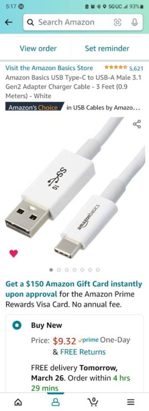

Had this issue in both my vehicles switched to a cable that is
USB-IF CERTIFIED: Compliant with USB 3.1 Gen 2; backwards compatible to USB 3.0 and 2.0;
No issues with either vehicle
