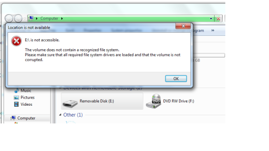

Wow, that got Recovery working again. Thank you! Only issue I'm running into now is when I go to mount my card through recovery my computer says it needs to be formatted first. Is this safe to do?
Re: **now with pics/proof** root,bootloader unlock,s-off at&t htc one x on 3.18 update!

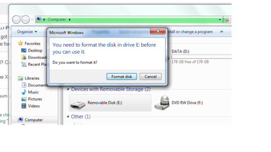

Hmmm formated? Could you send me a picture?

I'm afraid to format it for fear of losing TWRP again, or more... When I click it the screen shows it's 9.93 GB. My HOX+ has 64GB, or is the 9.93GB internal? Won't my internal have TWRP on it?
Twrp is stored in a different area of your phone. I guess to you could try to format it. You made it this far atleast. I'm not sure what it will format it to... Probably fat32 or ext3...

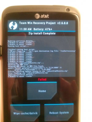

You were, of course, absolutely correct. I've tried all that I can think of on my end, but when I try and install my zip, it says unable to mount cache...
This is what I keep running into after an attempted zip flash. And Sideload won't even begin to work.
