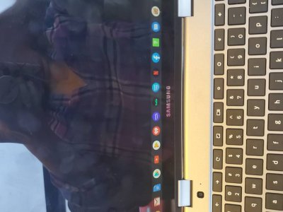

That's what bothers me it just did it again and I see the whole bottom row of apps. Here's a picture even though you can see my reflection LOL and I don't know why it comes out sideways

When you see that, what happens if you click the Chrome icon (assuming it's in the shelf)?
I believe it just opens a blank screen and I don't see anything still. But for now I just keep logging out and logging back in and it comes back.

The image the OP shared shows an overall black background with the icon shelf at the bottom, rather than half of a wallpaper showing at the bottom portion of the screen, so that's why I think the display itself is ok.
