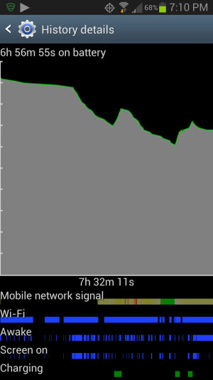

My S3 that I got used a few days ago has a weird battery drain thing. It will drain just sitting in my pocket, with nothing on besides cell signal and a strong WiFi connection. It will drain kinda quick when just listening to music through headphones, if I do it for like 45 minutes, it will go down about 10%. Right now, I'm listening to music from it without headphones plugged in, it's just sitting on my stand I have playing music through the speakers. It's been doing that for the past 30 minutes or so. The battery has only dropped like 3% at most. When I play Tetris, it will drain like 6% or so in like 15-20 minutes. Is there a fix to it? I was thinking maybe a soft reset, but I have no idea how to do that on the thing. Attached is a screenshot of the battery monitor thing. The reason the graph goes up in a couple places is because I was charging it while in the car and at school from my laptop.

Have you been in areas with poor cell reception? That can really suck battery life. You can tell by looking at Settings/Battery/Cell Standby, and see how much "Time without a signal" is listed.
I also recommend a good battery stats app like GSam Battery Monitor, which can give you a nice breakdown of what's using your battery.
When I'm at school, I have it in Airplane mode with WiFi on. That's from 8:15 AM to 3:30 PM. My bus ride is down I-95 and I pass through a couple areas where I have my signal drop. My time without signal is listed as 0%. I'm more concerned with the drain when I'm doing nothing being larger than if I'm doing something. Could me clearing the RAM and clearing open apps be part of it?
Clearing apps in an attempt to free up RAM (aka task-killing) is generally not helpful in Android, and you are correct, it can contribute to battery drain, since it takes some CPU cycles and therefore battery to open apps up again. Remember that Android wants to keep RAM mostly full, to improve task switching and accessing frequently used apps. See this article: RAM: What it is, how it's used, and why you shouldn't care | Android Central
It would be helpful to see your full battery stats with the battery down to about 20-30%, after starting from 100%. Remember that screen-on time is often the main determinant of how long a single battery charge will last. Depending on your use, your total screen-on time will usually be 4-5 hrs with a standard battery, and maybe 5-6 hrs with an extended battery (or a monster battery like the Droid Razr Maxx, Maxx HD, and the new Maxx).

That is pretty short battery life. Have you tried installing GSam Battery Monitor, as previously suggested? It can give you a better breakdown of what apps and processes are using how much battery and causing wakelocks.
That was with 18% left, I didn't want to sleep and have it die when I was asleep. I will install that app later today.
There are several things worth noting:
- (in the first screenshot) your cellular signal is marginal (it's that dingy yellow), which would account for poor battery life
- you're running Facebook - what a POS (less than 4.0 rating in the Google Play Store)
- (in the first screenshot) there are a series of Awake events that don't correspond to Screen On events - those apps that were recommended will help pinpoint the cause of that
