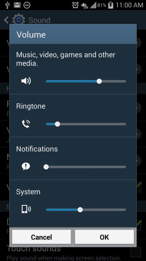

I have a Galaxy S4 and just solved this issue:
Tap the system access button to the left of the main home physical button, then:
Go to System Settings > My Phone > Sound > Volume
Make sure the Ringtone volume is not zero, then you can adjust the Notifications volume. In my case the Notifications volume had been turned down to nothing:
Note that you can only adjust the Notifications volume if the Ringtone volume is greater than zero.
Thanks

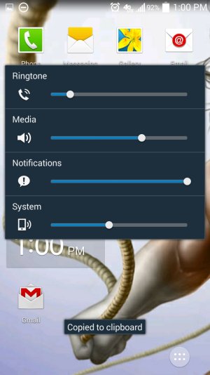

A follow-up to my own post:
There is a shortcut to the notifications volume:

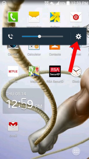

On your home screen, adjust the volume up using the buttons on the side of the phone. Notice the gearwheel icon:
Tap that and you have quick access to all the volume levels:

Had the same problem. Here's the fix I found: Push the volume either up or down, (doesn't matter) and you will see a settings wheel all the way on the right. Tap that, and a menu comes up, and "notifications" is one of the things displayed. Make sure that the "volume" adjustment is set so that it is all the way over to the right, which means that the "volume" for the sound for the text messages is on "high." Worked for me. Emailed Chomp and 3 suggestions as to what to do, and none of these worked because the issue was not an app issue; it was a phone issue.
