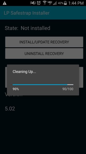

I did the process and i have root but safestrap is not working as ive pushed install many times and still wont allow me to reboot to recovery and supersu does not remove kingroot. any ideas? im also getting random alerts of unauthorized actions being detected
KNOX is responsible for the "unauthorized actions" message. Are you giving Safestrap "root authorization" when installing? Try un-authorizing it in the ROOT application, then re-installing it and letting it re-request ROOT priviledges. Remember to install safestrap, then after it closes, reopen it and install it a 2nd time.
edit: to get rid of the "unauthorized actions", after getting safestrap installed, reboot to safestrap and run the Knox_Removal_SU_BB_INIT.D.zip file.
I tried un-authorizing root and reinstalling and ive also tried completely uninstalling from the phone and reinstalling from the .apk. it says that the installs complete but it wont let me to the bootloader.Screenshot_2016-04-03-13-44-10[1].jpgScreenshot_2016-04-03-13-48-49[1].jpg
