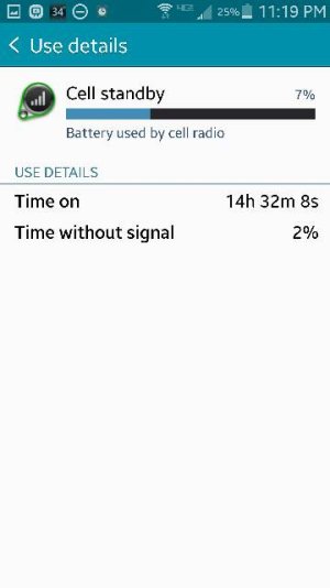

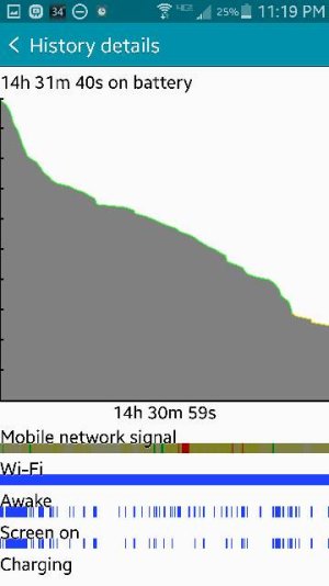

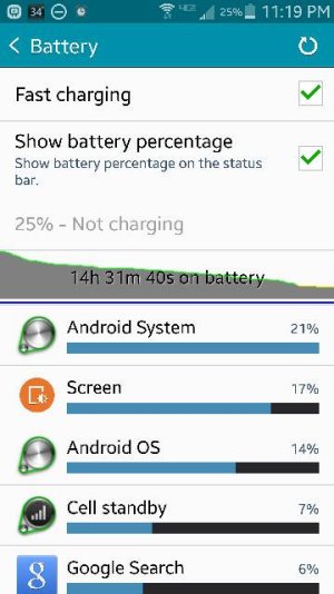

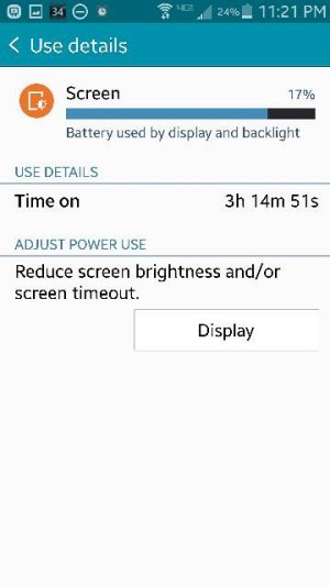

It would help to see some battery stats. Charge up to 100%, then let it drain to 20-30% with normal usage, without charging in between. Then show us:
1. The main Settings>Battery screen.
2. The fullscreen battery graph screen (which shows Awake time and Cell Signal Strength).
3. The Screen category (to see total Screen On time).
4. The Cell Standby category, if present (to see Time Without Signal).
http://forums.androidcentral.com/am...ide-how-post-screenshots-android-central.html
Also, consider wiping the system cache partition, which won't erase any personal data: https://support.t-mobile.com/docs/DOC-14686
Thank you. I have had it off the charger for a while. Even though these are not the most horrible battery stats I have seen they are far worse than I used to get. I did clear the cache when I notices the battery drain because I've noticed on several forum posts that this fixes a lot of issues.

I can't see anything that looks like the culprit from those screens. But I agree, the screen-on time doesn't look very good. Let us know if the cache wipe does anything. It might also be the phenomenon we sometimes see, where battery life is kind of crappy for a few days after an update, then it tends to settle down.
