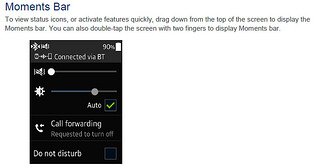

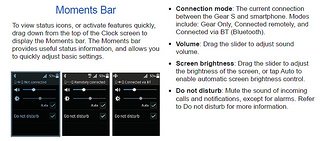

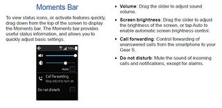

I'm starting to think the differences are less VZW-driven and more CDMA driven. The Sprint and VZW Gears have the same Moments screen with the exception of VZW omitting the connection type notification which is pretty typical of their controlling nature. They also have the same instructions for call forwarding in their respective manuals and neither make any reference to "auto call forwarding;" just call forwarding. So perhaps the CDMA Gear S radio(s) has some type of limitation the GSM radios don't?
