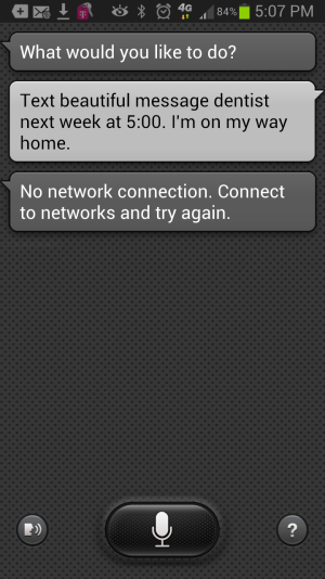

1. make sure wifi is off on your phone
2. double tap home button to launch s voice.
3. say text someone in your contacts (john or Call Bill) one of these two commands. txt or call
4. You should get a message saying can't find network. or something like this.
This is the issue I have been having since day one.
no issues on WIFI
Won't work on Tmobile cell service on 4g LTE.
Please reply if you are seeing the same thing or even get it to work and verify what version of Svoice you have.

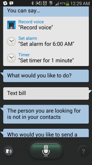

Please try to txt someone in your contacts, I got the same message, the person you are looking for is not in your contacts. If you tell it to txt someone in your contacts you should get the other error listed above.
