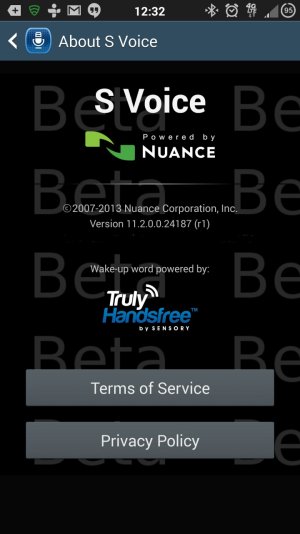

Mine works with no problem but it seems I have a different version of S Voice.
Deke218, where did you get this version of S-Voice? I've been searching all over for a working version.
EDIT: Nevermind, that's the same version I have that's not working for me.

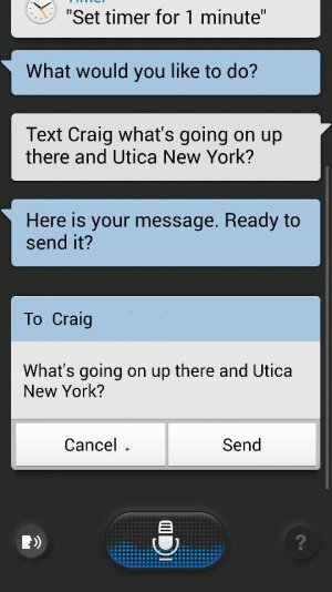

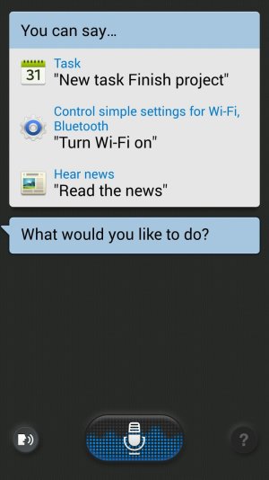

Yes, I'm on T-Mobile. On LTE though.
Works perfectly.
