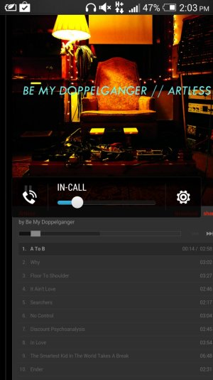

I don't know if this is actually getting worse or if I'm just noticing it more, but this is getting very frustrating and it's crazy to think that I'm the only one noticing it. In my latest experience, when listening to music on the bandcamp site, the hardware buttons got stuck on 'in call' volume, despite the fact that I haven't actually made any calls for days. It stayed this way no matter what I was using (native media player, youtube app, browser media) and even when I unplugged the headphones. I had to reboot the phone to fix it.

Same issue, especially when using bluetooth. Adjusting volume using hardware rocker shows 'IN-CALL' slider on screen, as opposed to Bluetooth or Media slider, and the volume of whatever I am listening to is not adjusted.
