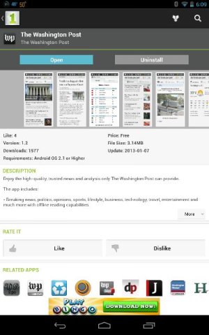

Okay, just to make sure we're on the same page, this is the Washington Post app that I'm talking about: http://www.1mobile.com/shareApps.php?ID=95454. This will open up in your browser, but here is what it looks like in the 1Mobile Market app:
I had previously uninstalled it, so tried to install it again, and it worked just fine.
