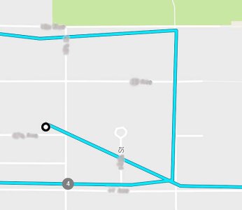

The GPS on my first run was crazy. Look how it crossed entire houses, The final distance was 1km less compared with my Garmin. I double checked on Google maps on the distance and it's on par with the Garmin. Don't have the opportunity to run with the S3 again yet.
