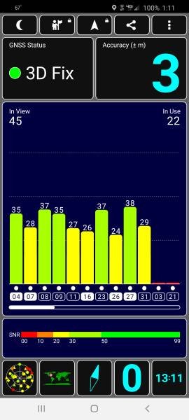

Just checked using a GPS tracking app. Keep in mind, this was measured indoors and is currently very cloudy/rainy weather.
That would depend on what the problem is. I'm puzzled why only some are seeing it. I keep checking mine but I get a signal every time.

Hmm interesting, I just tried now and was able to replicate the problem. Earlier didn't have the issue. Weird I didn't change anything and I don't turn off any services since I don't believe in turning off things
I also checked Google maps at the same time and no issue there.
