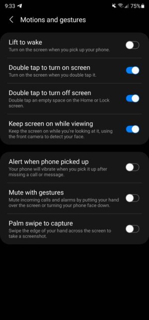

Hi, go to settings>advanced>motion and gestures
Play with double tap or lift settings , maybe turn off and see if it works ?

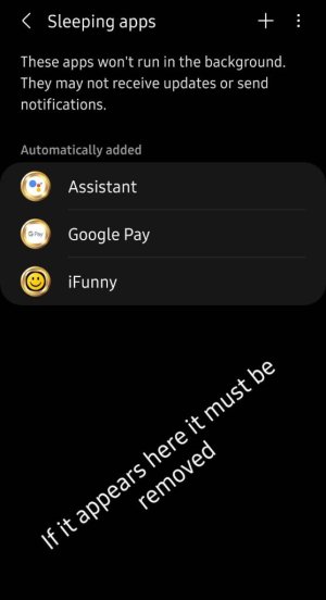

This is one of two issues. I started having similar issues after the update to Android 11 on my S20+. The first issue is Android 11 or One UI started putting all of my apps to sleep. The issue you're describing fits this perfectly. When the screen is awake everything works but if the screen goes to sleep everything that is in the sleep category also stops. Check Settings>Battery and device care>Battery>Background usage limits>Sleeping apps and Deep sleeping apps. If you find the apps that are causing you issues in either of these lists remove it and things should return to normal. I had a ton of apps show up in this list after the update so go through both lists carefully.

Mustang...........I have now turned all these off as it did have the double tap ones on the both of them and alert when phone is picked up.
Vid..................The battery app items are all off with 0 by the side of the 3 setting (deep sleeping etc) as i never had this on.

I'm not quite following your reply. If you go to the screen below and the apps are listed they should be removed. It's not an on or off thing. Screenshot_20210109-043523_Device%20care~3.jpeg

Hi.......vidjunky.........background usage limit is off so ....sleeping apps/deep sleeping apps/never sleeping apps is all 0 and ''put apps to sleep'' is off and power saving mode is off.

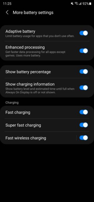

In device care turn on enhanced processing see if that helps Screenshot_20210131-112553_Device%20care.jpg

I have just turned that on,my only other very last option is a complete wipe of all back to default with only putting ebay/amazon/Gmail back in.
