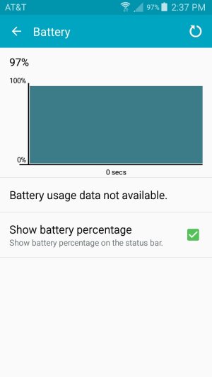

Changing to WCDMA only won't matter if your overall signal is poor. You can get an idea of the cell signal strength by installing GSam Battery Monitor (if your phone doesn't give that kind of info--I think Samsung usually doesn't have that information in the stock battery graph).
