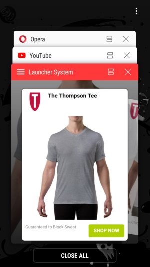

Recently I've been getting these pop up advertisement by launcher system on all apps. It's not frequent maybe every 30min. I've tried scanning apps using the play store and deleting maplestory m wich I've suspected since ads appeared after downloading it, but nothing. Is launcher system by Android or Samsung, are they now trying to gain more money? I doubt so what is it?

It's definitely NOT coming from your phone's OS (neither Google's nor Samsung's, trust me). The ads that come from Samsung show up as suggestions in the notification bar, and can be fully disabled from the Galaxy Store. That, unfortunately, comes from a 3rd party app (you can test this by booting into Safe Mode, wait the 30 minutes, and you shouldn't see any ads). A recent post suggested a popular GPS app as the culprit, but the truth is there are many out there that overuse this method of monetization. Usual culprits include File Managers and Battery Optimizers. Even if the apps weren't recently downloaded, sometimes an update can re-enable the setting to show ads.
When you see the ads, do you see a cog icon or a menu that you could tap?

So I've confirmed that it is a 3rd party app thanks to the tip. Since auto download was off i should be able to back track. Thanks alot for helping.
So I've confirmed that it is a 3rd party app thanks to the tip. Since auto download was off i should be able to back track. Thanks alot for helping. P.s there's no cog icon or menu.
Welcome to the forums. Try this, open the recent apps overview again, search for that Launcher System card, long press the small icon top left (the three horizontal lines) and then tap the info icon. See which app it opens.
I think I've deleted the app causing this problem but I'll keep this in mind in case it happens again. Thanks

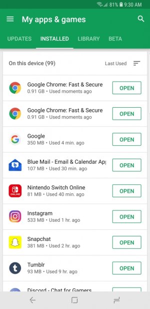

So I have also been experiencing this problem for the last week. Thankfully I found this thread because I thought it was my nova launcher. But even when i took it off I still experienced it. Since everyone is experiencing this problem from different apps I found the best way to pin point this was to do the following:
When the ad pops up I hit the multitask button to show all my apps open. Should say system launcher. I then went to google play store and went into my apps. Go to installed apps and arrange by last used. It should be one of the top apps on that list that is the culprit.
My device is a SGS8+ I'm not too keen on other devices ability to do this but hope it helps others!
