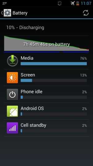

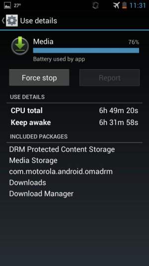

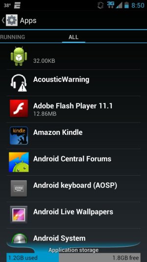

I updated to Jelly Bean early Tuesday morning and the last 2 days (Wednesday and Thursday) my battery life has been horrible. When I go into battery usage I see an app called Media that is using 3/4 of the battery. The icon is the same one as downloads in the app drawer, but I haven't downloaded anything nor do I have any ongoing. When I touch the app for more info, the report button is grayed out, and I can force stop it, but it will start back up on its own. I also found an app with no name in the app list which freaks me out a little. I'm thinking that a factory reset is in order, but I thought I'd see if anyone knows what is going on first.

SAME issue here, sucks... I had EXCELLENT battery life preJB, after, one day of what used to be my "normal" usage and I am right now sitting at 25% left, as where prior, I would be close to 50%+

Update: when I press the refresh button in battery usage the media app in question changes to android . process . media.... Don't know if this helps, but I thought I'd share it with you all.

Others have suggested that if a media file is corrupt, it might make the Media Scanner hang and cause excessive battery drain and CPU usage. That's why they tried taking the SD card out. If it still happened without the SD card inserted, could there still have been a media file on internal storage that was messing things up? One thing to try would be to delete all media files that you might have put in storage (music, videos, photos), then see if Media still causes a problem.

The fix:
Step 1: Remove all m4as from your sd cards to a folder on your desktop via usb storage; ringtones and all. I dont have any AAC files (itunes format) but they are m4as as well so I recommend removing them as well.
Step 2: Add them back one at a time, each time disconnecting from your computer and checking battery stats. If the file is ok you will see media server fall off the list within a minute. If media server hangs at 50% then that audio file is your culprit.
Step 3: If the offending file doesn't show itself, remove all audio files from your sd; mp3, wav, aiff, whatever. Use a mp3 repair app (I use MP3 Validator for Mac OS X | Christian Zuckschwerdt's blog for mac, theres eleventy-seven of them for pc. I dont claim to know which is best) to check and repair them and re-add them one at a time in the same procedure as step 2. Hopefully it wont come to this.
If none of these steps work start checking other media files. Corrupt video or image files might cause the same problem as they are all scanned by the media server.
Hope this helps
