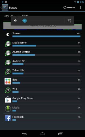

For some reason mine is also having this problem. I think I've isolated it to the Google Play Music app but it's strange because I haven't even downloaded anything from Google Play Music, nor have I started using their All Access service. Any help?
Sent from my Nexus 7 using AC Forums mobile app

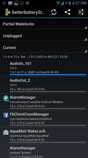

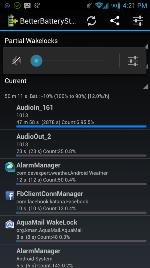

I've been banging around with this issue for a while, here is what I know so far:
  • It happens on multiple types of hardware
  • It happened to me on both stock JB 4.2.1 AND CM 10.1.0 (current OS is CM 10.1.0 on Galaxy S3 i747H)
  • I doubt the root cause is a specific application, but I suspect this is OS bug. I have read this dates back to 2010.
  • I have tried the various tweaks; reformat SD, look for wonky file names, corrupt files etc, etc.
See my screen shots for the wakelocks and battery stats as Mediaserver and AudioIn do their best to kill my battery. ONE CORRELATION I just noticed is this; I am losing the audio notification for events (text message, email), and this seems to coincide with the mediaserver drain/wakelock occurring. I suspect a connection between the lost audio notification and the wakelock under AudioIn.
I have tried everything I can think of and it's a dead end at the moment and very annoying. Any further suggestions are appreciated.

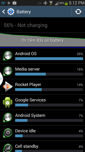

Here is a picture of my current battery stats:
https://dl.dropbox.com/u/32150068/Screenshot_2012-07-29-19-02-45.png
So what exactly is Mediaserver? I haven't done much video or picture viewing on my phone. Used a little bit of youtube app, is that counted under Mediaserver, or under it's own separate category?
Note that I listen to music constantly via Rocket Player (as seen in screenshot above), is Mediaserver linked to that somehow? Since Rocket Player is already at 18% that would total to 48% battery drain just off local music (not online streaming).
So I'm trying to figure out which app is using up all this battery, I don't have an actual 'Mediaserver' app, so I know it's another app that's accessing 'Mediaserver'. Any information would be great since my battery is draining hard from this and yet I don't think I'm actually using this app at all.
