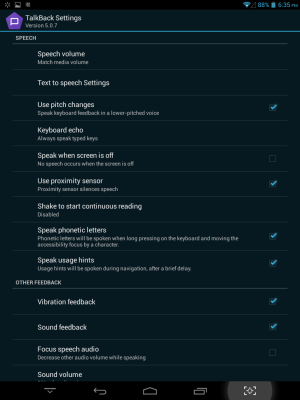

No joy trying to enable but not 'turn on' Switch Access on the tablet. There is no 'enable' option only ON or off. I have included 2 screenshots of the settings menu dealing with Talkback. As you can see there's nothing but an ON/OFF choice for Talkback. I did see an article that had driections for enabling Switch Access but it pertained to Android 5.0 and above, mine is v 4.2.2 and will not update. Unless you can think of something I am missing I guess I'm screwed.. to coin a phrase! :'(

To clarify, it's TalkBack that should be enabled but not turned on, and there should be a Switch Access toggle in the Settings>Accessibility menu that should be turned on. But it might be a Marshmallow and Nougat thing that is not available in KItKat.
In that first screenshot, what do you see if you tap the Settings button at the upper right?
Sorry I got the terms reversed, I know you said TalkBack needs enabled, no problem there sorry for the confusion on my part. The second file attached above is 1/2 of the SETTINGS screen
Somehow I missed sending it the first time.<sigh> nothing like expecting those helping me to be psychic! :-[
Anyhow that's pretty much it sadly I don't see any way to make Switch Access appear nor do I see a way to enable Switch Access w/o turning it ON. Once that thing is on it's a **itch to turn off since you can't scroll the screen to get at the icon for Accessibility.
