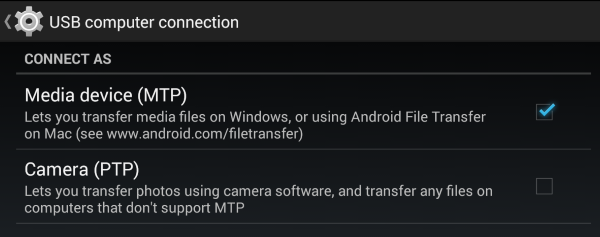

Make sure you have the correct USB transfer protocol turned on....you want MTP. When you plug your phone into the computer you can either go to your settings menu or you'll get a pop up like this
Select MTP
and your computer should then be able to view and transfer files using the usual drag and drop.
cpaight
I have never seen screens anything like your pictures. The only menu item under settings that mentions USB is “Storage and USB” under the device group, and that just shows amount of storage available and used. My O/S is Android v6.0, would those screens be for a different O/S?
After changing from the ISB 3.0 port to the USB 2.0 port on my HP folio 13, a screen came u- about USB charging. By swiping from the top, with difficulty I got four options and chose “use USB for ........ Transfer files (MTP)”, but it would not import photos. After choosing “Transfer photos (PTP)” the computer did a short driver install and it can now see the photos on the camera (both photos I previously transferred onto the phone and photos I have taken).
Windows Explorer previously showed an icon CW-Phone, which would not open. Now another icon has appeared MotoG3, which can find the DCIM and Pictures folders. So seems things are now working, thnks.
