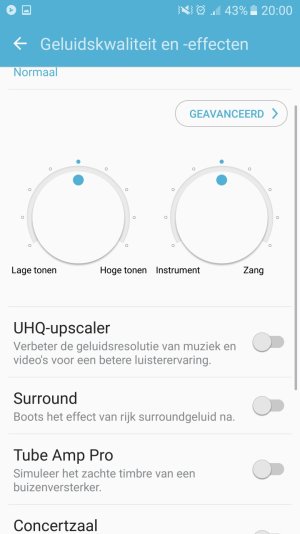

Ok, just found the cause. Apparently when you use the uhq-upscaler and other sound effects available in audio settings, it uses a lot of battery. I just turned those options off and now playing an hour of music uses 1-2% instead of 6-7%.2016-09-29 18.00.29.jpg
