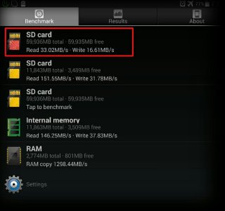

Here's the result using A1 SD Bench app:

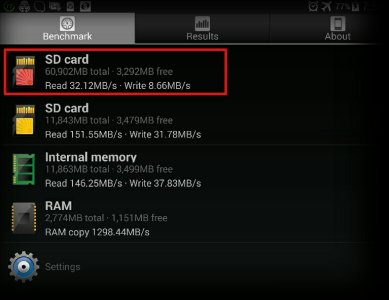

The write speed is almost double than my Scandisk Ultra:
Interesting that the write speed is double the SanDisk. I wonder if the lower free space has an impact. Did you re-run it and get consistent results?

Yup, consistent result. I also tested it by transferring a movie file 3.9GB from my laptop to the SD card. The ScanDisk Ultra took 8.8 minutes (8.35MB/s) while the Samsung Evo took 4.48 minutes (14MB/s) to complete the transfer. It's awesome!! Now I can transfer all my movie /TV series files at half of the time.
