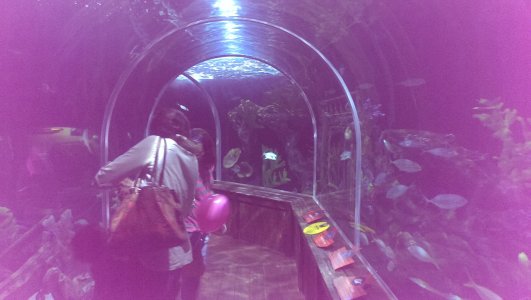

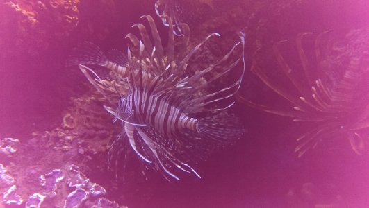

After spending the day with my family at a aquarium and not being able to take one decent picture, I think that I've procrastinated long enough to send it in. Getting on the phone right now with HTC.

Can you please post a pic or two for evaluation ???
I didn't see your post before, sorry for not replying sooner.
I usually use a digital camera as well for important stuff, but this was an out of the blue let's go see the fishies kind of thing.

Got my phone back about a week ago, couldn't get my hands on it till today. They've sent me a different phone. Looks brand new, so I'm assuming it's a refurbished unit. The camera is working great.
