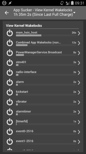

Gsam will. Under the app sucker screen there's a drop down menu to view wake locks. I use it regularly.
I believe GSam still requires root in order to view wakelock data.
I don't believe so. I use the paid version so I don't know if that makes a difference.
Hmm, maybe they found out a way to overcome the restrictions that were implemented in KitKat--it's why I had uninstalled GSam from my phone. I'll reinstall it and check it out.
I have Gsam free version and the wakelock feature is there under "app sucker". No root required. Very cryptic though. It's got a built-in button to help you searching in the Web about it.
