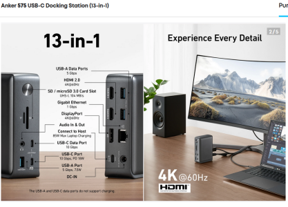

Looking at a bunch of Hubs/Docs in the past few days and these two look like they should work and give me a clean configuration on my desk i.e. my wife removing the laptop and leaving me with my S25U using Dex to keep me half way productive for a few hours or a couple of days.
I think either one would work fine with Dex. Does anyone have experience with either of these or other Hub?
The cost of the Anker 575 is $219.99, but the 556 needs a 100W wall charger and a quality charging cable which would cost $75 - 95, so the cost is fairly close in the end.
I've no experience with those, but at those prices, it may be overkill if you just want to use your phone on a monitor and/or with mouse/keyboard. I've used it with one of those sub-15-dollar hubs (most are flat, small, rectangular 4-port plus HDMI hubs) with one of the myriad of chargers I have lying around the house with no issues. DeX is nice, but not all that powerful and will not be able to take full advantage of the extra features on those overpriced hubs, TBH. I'd only get those if you have something else you'd like to use with them (like a more feature-packed laptop/computer), but to each their own.

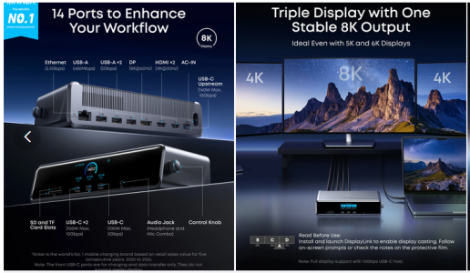

So back in May I heard Anker was coming out with new Docks and I am glad I waited this DL7400 looks like it will have plenty of longevity and the front USB-C ports will charge up to 100W would rather 140W charging but 100W should be fine. This will actually reduce the clutter on my desk and free up a couple of wall chargers for other places in the house.
It will be interesting to see if/how Dex can handle dual and triple screens. This set up will also allow my wife to simple disconnect one USB-C cable leaving everything else on my desk intact.
