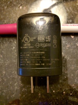

Just a stock Nexus 6 with Android 6.0, plugged in to a typical usb power adapter which is plugged into the wall.
OK, I just tried a different USB power adapter, which works. So there is something wrong with the combination of my phone and a USB AC Adapter HTC P/N 79H00098-29M, TC U250, 5V 1A. The charger works fine with my old HTC MyTouch 4G Slide....
Also, note it seems like it might somehow be damaged, since the display alternately shows the phone to be charging and not charging.
Damn! Here's a picture....
