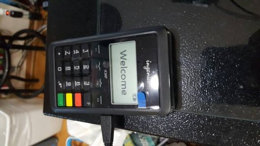

Just used it at this reader that I have never seen before.. u can barley see where to swipe it, It looks like a cell phone. Also I had cell service but no Internet here on vacation in catilina island but was still able to use it.

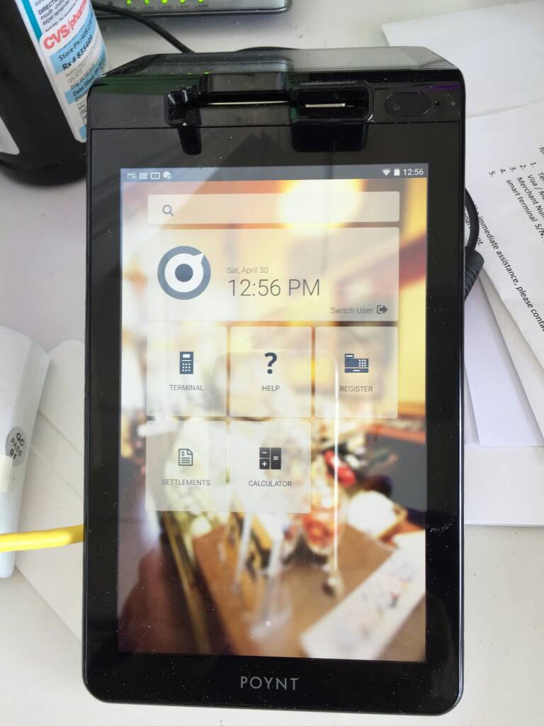

Merchant services are pushing the "smart terminal". We have recently started using Poynt terminal. It accepts magnetic stripe, EMV, NFC, Bluetooth and QR code.

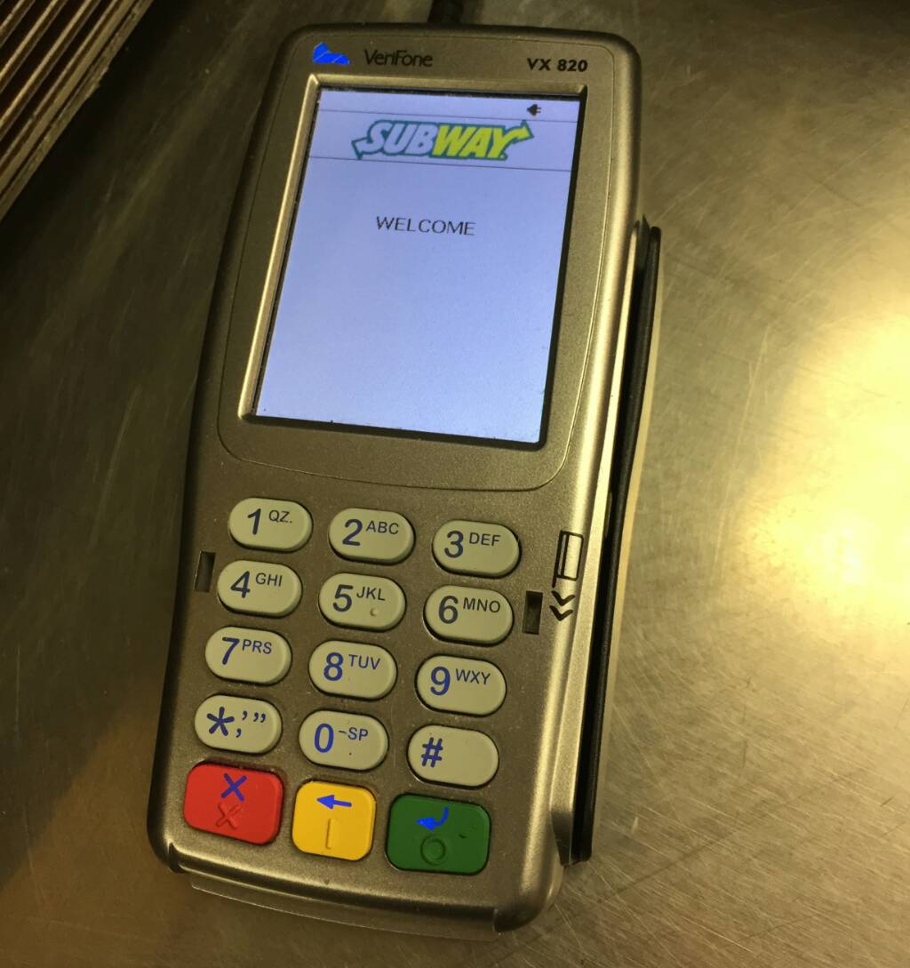

So I tried to use SPay at Subway, where they state they accept SPay and after the reader recognizes the 'swipe', it states DENIED. Tried twice and same issue. This is an ongoing issue for me where it rarely works and will work 1 out of 5 times if I put it through as credit, can't even think about using debit. I've called my bank PNC on three separate occasions and the reps tell me the same thing, its due to a bad reader. They don't to understand it can't possibly be every ready I've come across. I feel I'm ready to just give up trying SPay as I keep looking like a fool each time it doesn't work.
My subway has a old nfc terminal that works with Samsung pay. Might try nfc instead of Mst if your subway has the same old terminal.
Also wait in the cashier at Subway wait for the screen to say tap and pay or swipe. That happen to me initially and I had to wait on the cashier. Even doing it as NFC I would get the blue check mark on Spay but it didn't take. So I redid it and waited on the cashier then I did it and it worked.
