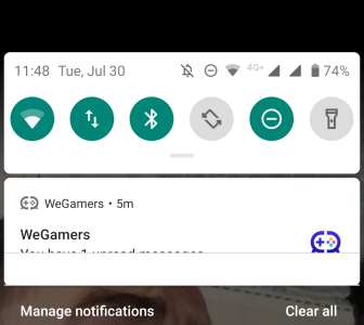

I have a (to me) very annoying problem. When I receive a notification on my Motorola One Vision, a white bar blocks about half of it, including the action shortcuts.
Does somebody have a solution for this? I have uploaded a screenshot of the problem.
I am running android pie and Nova launcher.
Thanks a lot in advance!

Sorry to revive this topic, but I have the exact same problem on my Oneplus 7 Pro.
I can't swipe down on it. If I tap it, it just opens whatever notification is behind it.
I'm also getting full screen ads, so I guess it's a part of that.
It does not happen in safe mode.
Would I have to reset to get rid of this?

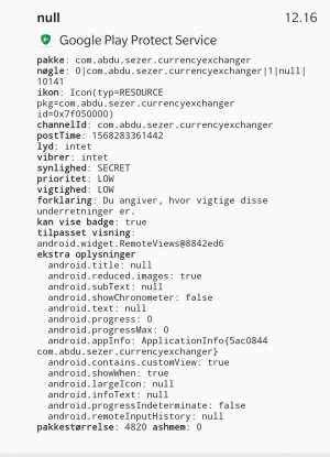

Welcome to the forums. It sounds like a third party app is pushing that white bar/notification. You could try this, long press an empty spot on your home screen - Widgets - scroll down until you find 'Settings' - press & hold and drag it to the screen - select 'Notification log'. Next time you get that notification tap this widget and see which apps are listed in the log. There's a chance you can find the culprit in there.
Cool, so I had a look through the log file and there's one that looks a little fishy.
Now how do I go about removing it?

Ok, so I went looking in the apps list and found Google Play Protect Service. At first I tried a Force Stop, checked if the white bar was gone. And it was! So I assume this was the culprit, since Google Play Protect Service is not a stand-alone app but a part of Play Store.

Do you have any app called Currency Exchanger?

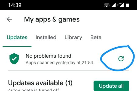

I would try this, enable Google Play Protect again - go to the Play store - run the Play Protect under "My apps and games" and see what you get.Screenshot_20190912-143956.jpeg
Nope, I do not have any currency exchange apps.
I forgot to mention that along with the white bar I also had some very annoying full screen ads. I downloaded an app called Blokada, that successfully blocked the ads.
I think that the Google Play Protect Service was just a way to disguise the app/malware.
I've had no issues since I uninstalled the app.
Google Play Protect is running in the Play Store and there seems to be no problem there.
I agree with you, If the Protect Service is still running in the Play Store that was probably an app disguising as a system process. Glad you managed to fix the problem.
