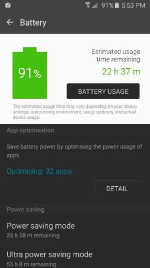

Check to make sure those apps aren't optimizing, check the battery in settings... Optimization was halting my notifications

I have a Samsung s6 and had this problem too of not receiving notifications even though all the settings seemed to be set correctly. What solved the problem for me was to go to Settings > Battery >App optimization > Detail, turn this off. I started getting notifications immediately.

Going inside the battery tab does not show "App optimization" in it for me.

that work for me it was restricting notifications in the battery section under power saving now I am getting all of the notifications for Samsung S6
go to batterysettings
power saving mode
un click restrict all background data
