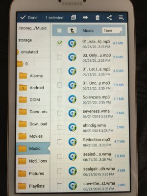

Just try to drag and drop directly to the Music folder in your internal storage. If it works, don't bother to use Kies.
Go to Setting, About Device, click on Build Number 5 times to turn on Developing Options, then check USB debugging, uncheck Verify apps via USB.
Connect my tablet to PC via USB cable, under 1 minutes, I have over 100 songs in my Music folder
