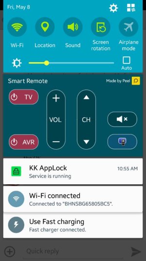

No, it's there. If you're charging with a Quick Charge charger then pull down your notification bar and it will say "Use Fast Charging, Fast Charger Connected."

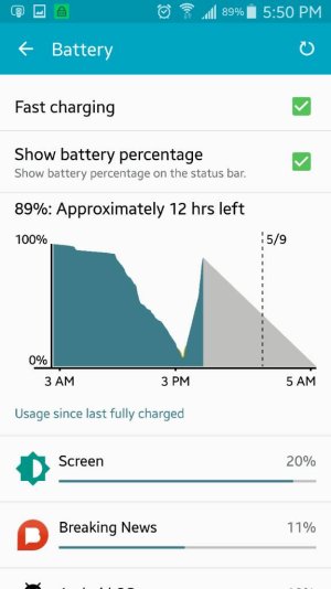

My notification shade shows this.
Is "fast charging" checked under Battery? I can only check and u check it when I am not charging.
Also, are you using the charging block that came with the phone?

I am using original charger which come with the phone fast charging was working prperly before the last update , after it does not work it take more than 3 hours, if using mobile with gps on the battery charge level remain same level even plugged to lighter car adapter ,
When charger plugged the power fast charger check become lighter not green and it is freezed , when charger off it become green and the box could be checked or not
