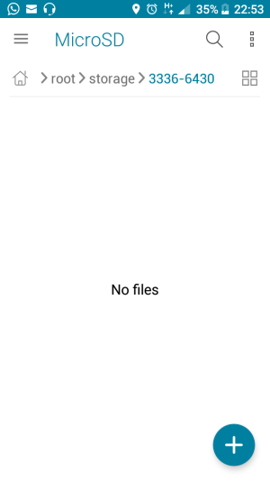

I've attached a screenshot of what the file manager shows, it's root/storage/336-6430, not mnt/extSdCard. Is that okay? It shows the SD card and capacity/use but that's what happens when I click it to browse.
VLC shows the same directory, but it's just perpetually loading when I open it. Another music player let's me use 'files' to browse, but when I go to play anything it says it's a protected file or something like that.

It's fine in a PC. Just looked at the format though and it seems to be exFAT, could that be the issue? Maybe formatting to FAT32 would solve it? I'll try that now anyway and let you know.
I probably should have thought of that to start with! Because Android gave the option to use as portable I assumed the format was correct.
I tried my 64gb card in it, and Audible, VLC, and File Manager all see it, so it's definitely to do with the card.
