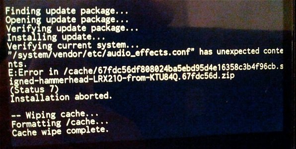

beginner....help! status 7 error
on attempting to install 5.0 ota on nexus 5; the installation process aborts giving a status 7 error.
It says that there are some unexpected contents in one of the system files followed by a cache error.
Pls suggest a simple solution for this.

I have attached the screenshot

Re: beginner....help! status 7 error
Did you see gone down south's questions above? If you have any of the following components on your phone, an OTA update will NOT work.
  1. Custom Kernel
  2. Custom Recovery
  3. Root
  4. Custom ROM
From the error message, I would guess that you rooted your phone and installed some sound effects on the system, such as Viper Audio Effects. In that case, you will need to wipe the whole phone and flash Lollipop freshly. You might be able to get away by restoring the original contents in /system/vendor/sound_effects.conf, but I wouldn't bet my money on it.
Yes, you are absolutely right. I had installed towelroot followed by vipersaudio. When u say "wipe the whole phone", do you mean to say factory resetting? I have tried factory resetting and deleting cache images a couple of times but it doesnt work. Sorry if my questions sound dumb but im new to android and not well versed with the technical terms. Pls help to resolve this issue...thanks

What I meant to say is that you will most probably need to flash a full factory image of Lollipop onto your phone instead of applying an OTA update. In plain English, you will erase everything on your phone and freshly install Lollipop. Below is a link that explains how to do it.
http://phandroid.com/2014/11/12/how-to-flash-the-android-5-0-factory-image-on-the-nexus-5/
Your question is certainly not dumb. OTOH, this process may be overwhelming to someone who's relatively new to Android. I would suggest that you read the above link first to see if this is something you're willing to try. If not, please let us know here and hopefully we will be able to work something out for you.

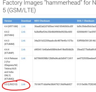

Hey, flashing the full factory image seems to be a difficult procedure even after following the link. I have never done anything like this before and have a few questions:

4)Pls have a look at the attachment and confirm if i have chosen the correct factory image to download?

4) Yes, LRX21O is the correct factory image for your Nexus 5.
