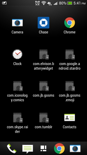

Recently I was clearing out apps I don't use anymore from my HTC One X and thought that after going through the simple uninstall process that'd be the end of dealing with the apps. To my surprise though, I keep getting these icons that list the apps by name but when I select them I get the message "app not installed". The only thing I can do with them is to uninstall them but they keep randomly coming back. I'm not sure what to do and any advice would be greatly appreciated.
Here's a screenshot if that helps. As far as I can tell they aren't being used with any other apps, they only show up there in the drawer, and I've tried all 3 methods of shutdown after I uninstall them and seem to go away for a bit, but then return seemingly at random.
This is a different one... I have to say that I've not seen anything like this. What I would try would be to install one of them again and then uninstall it just to see if a second uninstall will stop the phantom. If not there are several uninstall apps at the PS, Uninstaller was one that I used and liked, then install the program and uninstall it with the app. It seems like the stock installer is missing something.

Looking at your screenshot those aren't even the app names, those are the folder names that the apps would be in when installed on your root drive. Meanwhile, if you haven't been able to remove them I would try a File manager like, Astro, File Manager, or ES File Explorer, and see if you can't track down those folders and try removing them. Backout as far as you can on the root drive and navigate to one of the folders that is not your SD Card. On one device I had 4 folders I could see, with one being the SD Card. In one of those you should see a lot of folders named like the ones seen in your screenshot, com.xyz ect ect.
