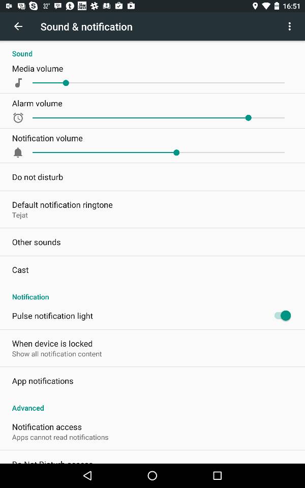

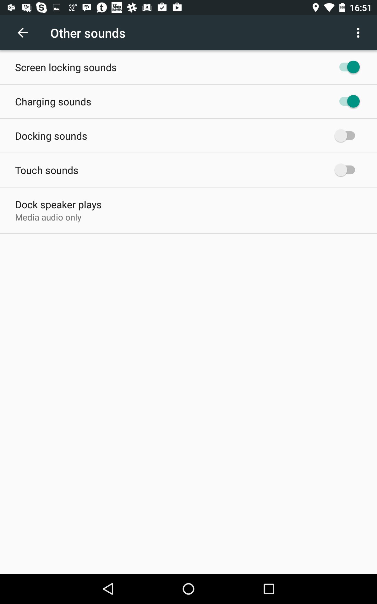

The tapping sound is a setting
It's in other sounds, touch sounds. I turned it off on mine.
I don't mean the sound setting. It's a hardware issue that happens *after* the sound setting turns off.
