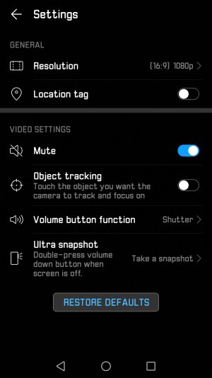

On the P10 the setting is [16:9] 1080p (30 fps), encoding H.264
On the S9, the setting is 16:9 FHD 1920x1080 (30 fps), HEVC off (no mention of encoding)

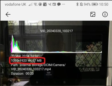

I've just recorded an identical 20-second video on each phone. The S9 (with HEVC off) stores this in 4MB. The P10 takes up 44MB. I don't know whether it's a clue but there's an 'info' button on the P10 and when pressed it shows some sort of graph which to my untrained eye shows a lot of activity in the first few seconds - perhaps translating into a lot of storage?....

The S9 doesn't have a similar facility.

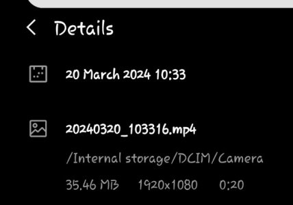

Although the S9 video only takes up 4MB on my Windows pc, I've discovered that on the S9 itself it's taking up 35.46MB...
I've been using WhatsApp to send it to my PC (which is where I do all my work), so it seems that WhatsApp does a 10:1 compression.
I've not tried this before with the P10 video - I've been simply connecting this to my PC via USB and doing a file transfer. But when I use WhatsApp on this too, it ends up compressed to 3.6MB.
So it seems clear that WhatsApp performs roughly 10:1 compression on video files.

Aha! Yes, it seems that WhatsApp automatically compresses videos to SD quality (480p), which would explain a lot: https://9to5mac.com/2023/08/24/whatsapp-hd-videos/. It looks like you can now choose to send videos in HD now, but I wonder if there might still be a little compression involved with that.
