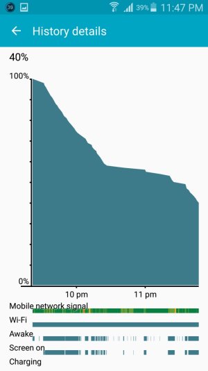

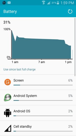

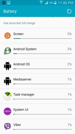

It would help to see some battery stats. Charge up to 100%, then let it drain to 20-30% with normal usage, without charging in between. Then show us:
1. The main Settings>Battery screen.
2. The fullscreen battery graph screen (which shows Awake time and Cell Signal Strength).
3. The Screen category (to see total Screen On time).
4. The Cell Standby category, if present (to see Time Without Signal).
http://forums.androidcentral.com/am...ide-how-post-screenshots-android-central.html
Re: battery drains so fast
That doesn't include all of the screenshots I had suggested--can you show those? Also, why is there a slight increase in the battery level early on? Did you charge up at one point? Make sure you show us the stats after discharging from 100% to around 20-30%, without charging in between.

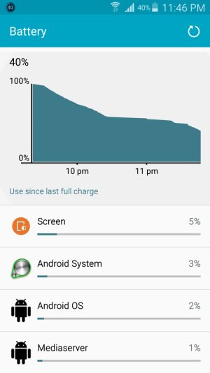

i have recharged till 100%, n i have used it normally bur when it reaches 30% , mobile switchs off automatically, when i switch on it says battery low ith 0% of battery,,, i can show battery status above 35% not below that
Ok, then use it down to about 40%. What about my other questions?

Does that account for only about 2 hours? How long was the screen on for? Looks like half of that or less. That is pretty lousy.
Try calibrating the battery monitor software. Charge to 100%, then use it until it shuts off. Charge back up to 100%, and repeat this cycle about 3 times. See if things get back to normal.
