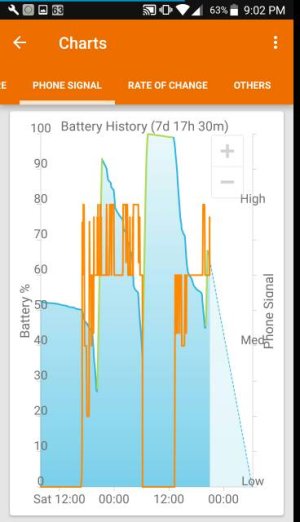

I don't know if these are extremely accurate because I keep my phone off most of the time (Always On Display is always activated). My battery decreases by 1% every 4 to 5 minutes (Ive been using the android central app for the past 20 mins now). Also, I've been using this animated wall paper called forest just in case that helps. Hope the screenshots tell something; I'll be posting a new set the next time I charge it to 80 ish% and I'll use it normally.

Sorry -- it would just be good to see all of the screenshots before making a guess as to what the problem might be. Can you post them using the desktop AC forums site instead of the app?
From the screenshots I could see, at least it doesn't look like poor cell signal is a culprit. Do you have an SD card inserted? If so, unmount it and remove it, then see if that makes a difference, since a corrupt media file on the card can cause the system to work overtime while the Mediaserver tries to scan that file and include it in the correct media database.
It'd be helpful to see how long the phone is being kept awake as well.
