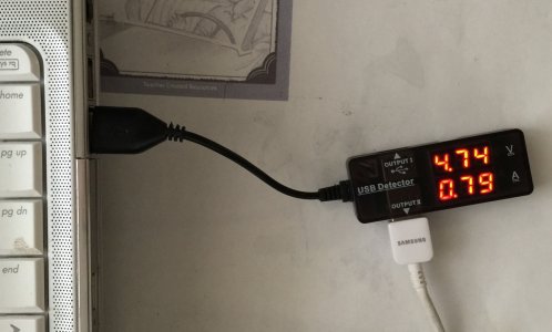

You should not use an USB port on computer as the source to charge your Note Pro. It doesn't have enough power to charge your tablet. Second, your tablet draws more current than the computer's USB port can supply, I guess your Internet slow down due to voltage and current drop in main board's circuit which leads to the network adapter.

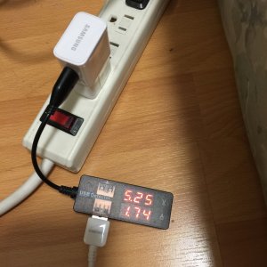

Galaxy Note Pro requires an adapter with output of 5.3 Volts, 2 Amps to charge properly.
