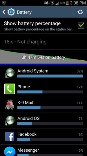

Today I got up and it was at 2%. I charged it from 8 am to noon and took it off at 100%. By 3:15 I was at 18%. Nothing was running at all.
My battery indicator told me a mail program was running (must have been a mistake).
I frequently run Battery Doctor and am told tons of programs are running (some I've NEVER run) and I let Battery Doctor kill them. I also clear programs a few times a day.

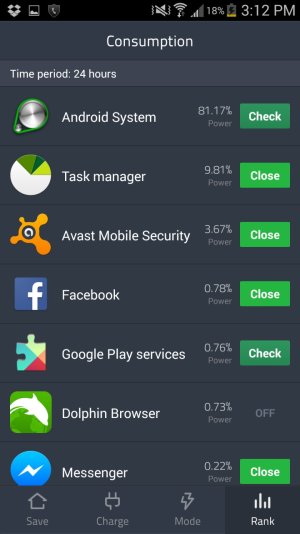

My post. Here are some screens. During this time I did NOT use the phone at all. It was just sitting on my desk.

What I have learned is that app killers and cache cleaners used on a continual basis will cause the "andriod system" to hog the battery at a more rapid pace. because rather than rely on a cached process, the the Android system has to restart a process which is CPU intensive. so until I feel the phone is bogging down with a large cash only then will I use an app like crap cleaner or clean master. and then restart. Because clean master is always running I install it use it uninstall then reboot. Also maybe others can answer but my samsung appears to have built in antivirus. So running an antivirus app on top of native antivirus will surely slow the phone down. but I can't answer that for sure not knowing your config
Re: S4 Battery Life under 4 hours! Yep. Hours!
And right you are ItsBond007. I uninstalled Battery Doctor last night. Charged overnight. Now, after 8 hours, I'm sitting at 86%. The best I've EVER seen. Google Play Services is #1 at 18% and Android System is a puny 17%. I'm overjoyed.

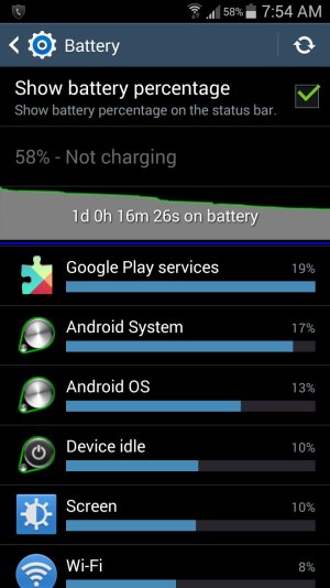

Follow-up. After sitting all night without the charger I see this. The best I've EVER seen on either of my two Galaxy phones.
Thinking it through it seems obvious. With my Old Galaxy, the battery life started getting bad so I installed Battery Doctor. Things got worse and worse until I got the new S4. To keep ahead of this new one, the first app I installed was Battery Doctor. Slowly but surely battery life started downhill again.
Now that I think about it, I was the one who killed that battery. Yippee and Thank You everyone.
