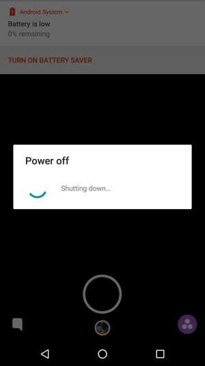

If I use Snapchat to view or make a video the phone will power down even with as much as 90%% battery. A warning comes up saying something like "0% battery phone powering down" and the phone turns off.
Basically, it seems Snapchat makes my phone think it has no charge. The phone dies and won't turn on unless it's connected to the mains even though, once it's booted up again, it can still have plenty off battery left.

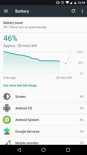

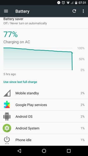

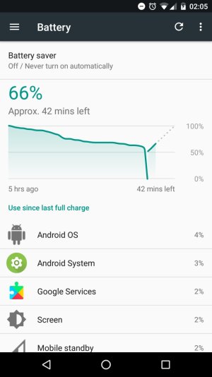

The attached screenshots hopefully show the complete emptying of the battery when this problem occurs and the level of battery when the phone turns on again.

A fresh install of the app didn't seem to cure the problem (I tried taking a video and got the same "Lower Power" shutting down issue as before) and I've just tried clearing the cache / data and logged in again but again I have the same issue as before. Couple more screenshots attached.

Bummer.:-\ The battery graph really looks like what happens when a battery dendrite forms (which, unfortunately, is irreversible). But I would expect that behavior to happen regardless of whether you were using Snapchat or not (which is why I was asking if it happens any other time). Could it be that it seems to be caused by Snapchat only because you use Snapchat a heck of a lot?
