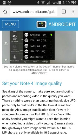

Saw this on another site. Says that "video" stabilization is not available if camera is set higher than full HD for video recording.
I've noticed for awhile now that the video stabilization button (in camera settings) greys out when WQHD and UHD are selected and have wondered WHY?.
My question is - "Why is that the case when the camera lens is built with "OIS" and not digital image stabilization?"
One would think that OIS would work regardless of whether you are in Camera or Video mode.

It does have ois when recording in 4k.the stabilisation in the settings menu is digital stabilisation.
Why would it be necessary to give you a digital stabilization option when you already have optical image stabilization?
You can't turn off ois because it's like a physical shock absorber,where as digital is just processing of the image and so can be turned off.
So it would appear then that video image stabilization, when recording at WQHD or UHD, will not be as effective as when recording in full HD since the software will not implement the digital stabilization.
Correct.
But having just the ois in 4k recording is still good and better than if it were just digital image stabilization on its own.
OK. Guess if I record video where stabilization will be paramount (such as on a roller coaster, bumpy auto ride etc...) I will make sure to do so in the lower HD resolution.

When UHD mode is selected for the first time there is a pop-up telling you which functions are not available. I have seen videos on YouTube where it shows someone getting that pop-up and stabilization is NOT included as a lost function on their Note 4. I have also been to the local Best Buy and tested a Note 4 that has the pop-up and stabilization is included as a lost function and is disabled. The Best Buy Note 4 was running lollipop. I am guessing that the Note 4 lost that important feature in the upgrade from KitKat.:(:(:(

Ois wasn't available for 4k in Kit Kat either. Maybe it's carrier specific but on my AT&T Note4 it wasn't available.

Looks like the AT&T and Sprint don't have stabilization in UHD. I have noticed that the US usually gets inferior technology. Maybe it only available overseas with the faster Exynos 7 Octa 5433 64-bit processor.
